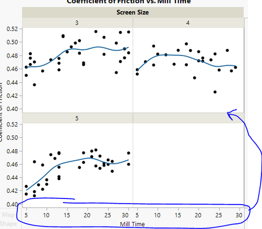

We are trying to generate multiple graphs using the wrapping function, but the axes only show up on the outer edges of the graph.
What is the improvement you would like to see?
Would like the ability to add x/y axes to all of the graphs within the wrapped graph (see figure)

Hi! The answer is all of the above, but mostly it's for presenting/publishing. That way the individual graphs can be used in a presentation. Thank you for your response!

Hi @ceebee, to get the additional axes, you can use page instead of wrap:
