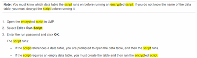

Hopefully the below snip comes through from the info on encrypting scripts.
The whole "you must know which data table the script runs on before running an encrypted script" is the issue.
For instance, in my most common scripts, when you click Run (via the run button or an addin) a modal dialog pops up and the user fills in the inputs (generally navigatijng to various file locations). Upon clicking OK the variables are gathered and the rest of the script continues. There is literally no way to know "which data table the script runs on"
I would expect that just encrypting that script would allow me to run it and the modal dialog to pop up as it normally would. This isn't the case and I get an error "Unable to open in Read Only Mode. The system cannot find the path specified. in access or evaluation of '<encrypted>' , "<encrypted>" /*###*/"
This error occurs after saving AND also if left alone or placed in the JSL Encrypted() function. I will see if I can't make a small script to illustrate my issues that I can pass along in both encrypted and normal formats.
