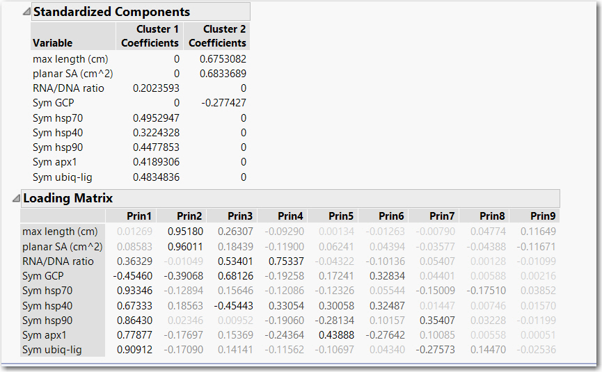

  1. Ran MultiDimensional Scaling on  columns max length (cm) thru Sym ubiq-lig specifying the data format as Attributes and asked for 3 dimensions. I am not familiar with this data and have no context so I specified Trasform None .Then Save the Dimensions. This saves Dimension 1 - Dimension 3 scores.  The graph of Dimension 2 vs. Dimension 1 shows some groups. However, I have little experience with MDS and more with Ptincipal Components ...
  2.  Ran Principal Components on these same variables. Below is a screenshot of the std. components of variable clustering and the loading matrix for the variables.  Prin1 is a mtrix for the Sym variables except for Sym GCP; Prin2 seems to be related to size and Prin3 some genetic chracteristics. Save the first 3 components.                                               image.png

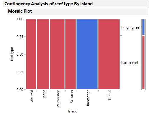

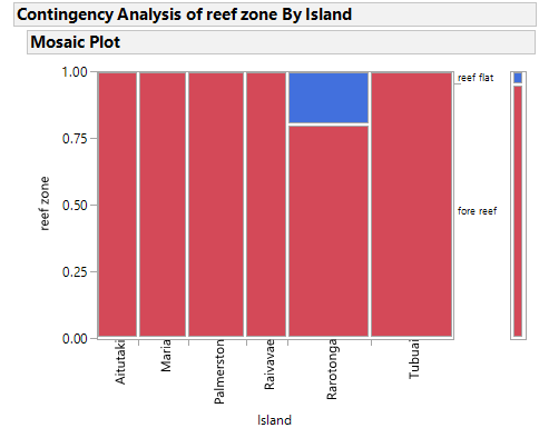

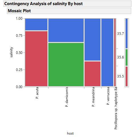

  3. The character variables seem difficult to work with and I think you should score them, like temperature, or salinity. I just added some Value ordering like color, I ordered them as normal, pale, very, pale, bleached. At this step you could use stepwise for the 3 responses Prin1, Prin2 and Prin3.  However, when there are variables like Country and Island, I like to look at characteristics. This looks like availabe data. Below are three examples.  Not knowing this data and the fact that certain characteristics are nested (specific) to others, like Island or Host, and all effects are nominal, I will not recommend any specific method nor provide an analysis.  However, Host, salinity and color seem to be important.  Plot the dimensions or the principal components by Host to see the results

   Thanks so much for taking a look at my data. As a similar conclusion to what you came to, I ended up having to throw out several environmental parameters (reef zone and reefy type) because they were either so unbalanced or they scaled with island. I ended up just using 1) island, 2) temperature, 3) salinity, 4) ALCC, 5) depth, 6), sampling time (proxy for light), 7) colony color, and 8) host species as environmental factors. Then, I only used one of the two size parameters (max. colony length) since they give virtually the same information. I also concluded that "host" is likely to be the most important factor when using PCA, stepwise regression, and a few other approaches on JMP.
