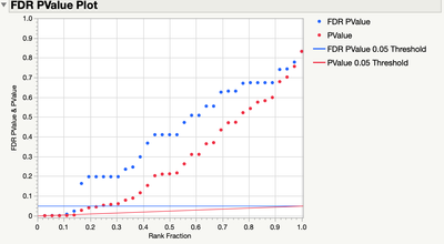

@Bluesky can you provide some additional information for us?  In response screening, we currently display on the FDR PValue plot the PValue = 0.05 and FDR PValue=0.05 lines.

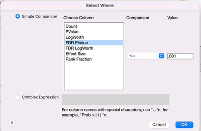

We also provide the ability using the red triangle menu to "Select Where", and specify a criteria to select comparison results, where you can pick your own PValue threshold to use.
Does this meet your needs, or is there something else we can do to meet your needs?
