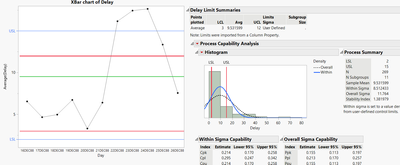

What inspired this wish list request?When you add the control and spec limits property to a column, it's practical because these limits are displayed directly in the control charts and in the process capability analysis platform, for example. The problem is that in the control charts, the specs are blue and the control limits are red, whereas in the process capability analysis platform the specs are red.  You can change spec limits color in control charts, but not in process capability analysis platform. On the other hand, you can define the color of the control limits in process capability barchart, but not the specs limits.
What is the improvement you would like to see? Better color consistency between different platforms for spec and control limits, and customizable even when the column property is used.
Why is this idea important?These different colour codes between platforms can be confusing for users.

Thank you for submitting this request. To address the inconsistency, there is a new preference under Process Capability Analysis called "Use Control Chart Spec Limit Line Colors". When this is turned on the LSL, Target, and USL lines are blue. This will be available in the next release (JMP 19).
