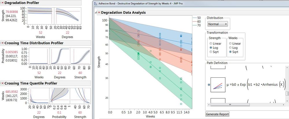

The new Destructive Degradation Platform (I believe since JMP 13) provides a number of excellent Profilers for analyzing crossing times (see example below for the Adhesive Bond example data). It would be fantastic if the Repeated Measures Degradation Platform had the same kind of Profilers.

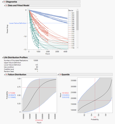

You might want to take a look at the profilers in the new Repeated Measures Degradation platform in JMP 17 (see screenshot below). Not quite what is being requested, as these profilers won't allow you to conveniently change the temperature and threshold to show new CDF and Quantile profilers. You must determine the value of temperature and threshold first, but you can provide a new set of temperature and threshold values to generate new profilers for these values. The reason for this design is that it is much more computationally intensive to generate these profilers.
