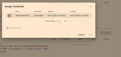

Thanks for the new Data Connectors :)
hogi
Level XIII
@Sarah-Sylvestre .
-> wish can be closed.
