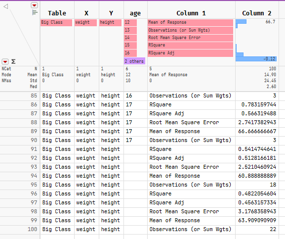

What inspired this wish list request? I got into a bug(???) where if a Combined Data Table was made on a collection of plots with various Group By columns, they were lost.
Let's run this code:

You'll get a Fit Group where the last Bivariate has a different Group By column (:sex instead of :age)
Then let's click on the first "Summary of Fit" and select Make Combined Data Table.
We'll see that the age column has missing values for the plot that has Group By column NOT :age, and there is no column called "sex"
Age column has missing values where Group By column is not AgeAge column has missing values where Group By column is not Age
What is the improvement you would like to see?
Group By is as much of a variable in analysis as X or Y. Why don't we have separate columns for it? Group By Name and Group By Value? This will make automating further analysis much easier.
Worst case scenario, when making combined data table - just use the same logic as concatenating tables with non-matching columns - all columns get in the result with missing values where column did not present in the table.
