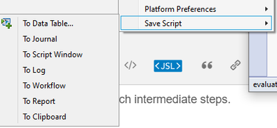

At the moment, there is a workaround - but with some limitations:
Get the code for the intermediate step as part of the final script of the report, e.g via the Save Script menu:
The problem: the manual change is coded via SendToReport & Dispatch - and talking about good JSL code, SendToReport & Dispatch are not intended to be used directly for your own code:
