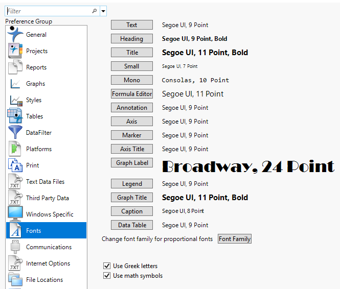

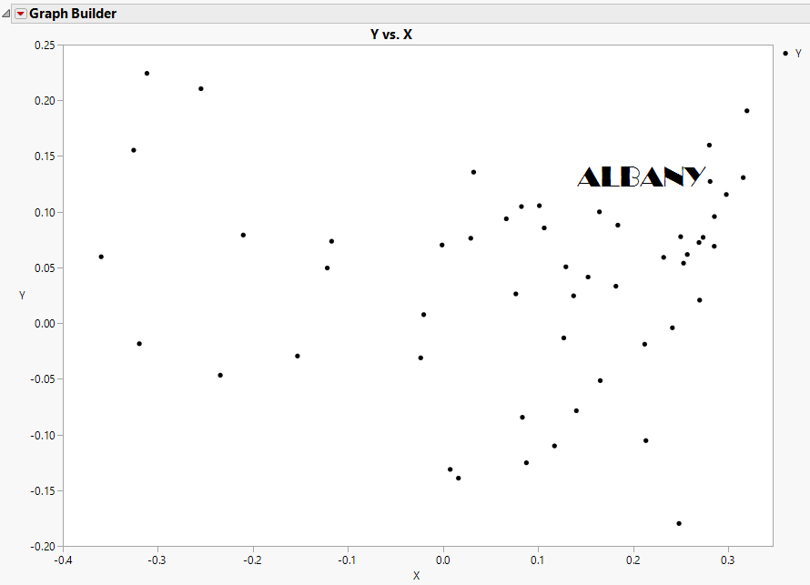

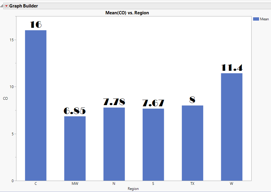

Not sure if this is exactly what you are looking for, but in JMP 15 there is a new graph font preference for graph labels. It only affects labels on data elements within the graph. For example, the value labels on a bar:
Or row labels shown on markers:
The preference is here under "Graph Label":
