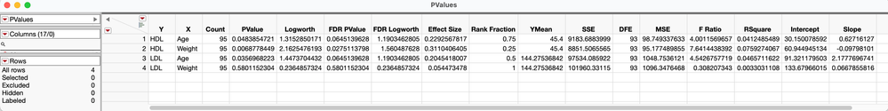

Also @MShroff , there is a JSL function, Summarize YbyX( ), that might be helpful for what you want to do
Names Default To Here( 1 );
Open( "$SAMPLE_DATA/Lipid Data.jmp" );
Summarize YByX( X( :age, :Weight ), Y( :HDL, :LDL ) );
which create a summary table of the regression coefficient estimates and fit statistics as shown below

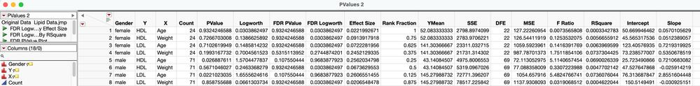

Also you can use By variables by specifying them with a Group( ) argument to the function
Summarize YByX( X( :age, :Weight ), Y( :HDL, :LDL ), group(:gender) );

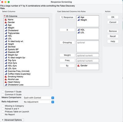

Also, the JSL is just a short-cut to get the final result table that you can generate from the Response Screening Platform (Analyze > Screening > Response Screening)
