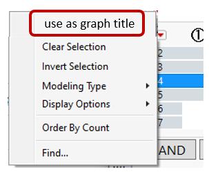

related wish:
Local Data Filter: option use the selection as graph title
a new aspect from there:
an option to specify which selections are added to the title - and which ones not:
