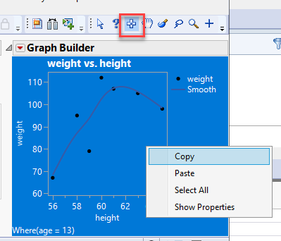

I like the idea of making this an option but since the local data filter info is at the bottom of the graph I often find the current title is sufficient. Maybe that is because I almost never use the default title in reports or presentations though. Note that to copy the where clause with the graph you can use the selection tool (S) and right click to copy.  I could see options to append the where clause to either the bottom of the graph, the end of the title, or both, and maybe some way to decide whether to include the graph title and the where clause when copying the graph.
