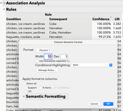

An additional item: Can the format for Confidence be made user-customizable? For example, I'd like to see a few decimal digits.
Regards
Mehul Shroff
Sarah-Sylvestre
Level V
mia_stephens
Staff
Hi @MShroff ,
To change the number of decimal places for Confidence, right-click on the Confidence output and select Format Column.
Mia

Hello @mia_stephens
Re: change=ing the format of the Confidence column, can this be made available in preferences?
Regards
Mehul Shroff
mia_stephens
Staff
@MShroff , we are working on an easier way for users to save platform customizations like this. That said, is there a desired number decimal places to display by default?
MShroff
Level VI
Hello @mia_stephens,
I personally use 4 decimals for percent but I think at a minimum, having 2 as a default would likely be optimal for most users.
Regards
Mehul
mia_stephens
Staff
Thank you for this suggestion @MShroff .
