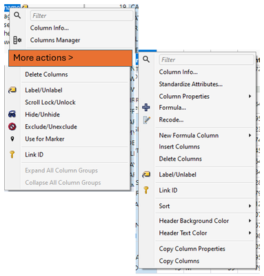

Browsing columns pane is fast and it can be filtered down quickly and you cannot do that with column headers (or with the table). I would like to be able to perform more actions we can perform from columns header from columns pane. Especially copying/pasting/inserting but I wouldn't mind if I had all the possible options under some new drop-down menu.
One possible mock-up of the idea (there are some options which shouldn't be included and some are duplicated)

nowadays, one has to double-click the column in the columns menu, find the right column header and then right click and New Formula Column ...
Every user has his favorite functions - and most likely they will not be in the right-click context menu which is used in the columns menu.
