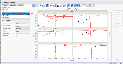

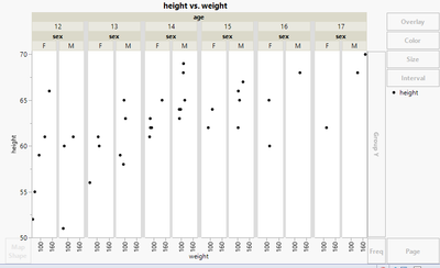

So go from this:
to this:
Why is this idea important?
This allows more the Group X axis to be more useful when looking at two columns you'd like to stack in the axis (and frees up even more drilling down possibilities since now Overlay can be used for a third column)

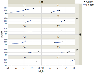

Interesting:
- there is Wrap available to generate sub-groups for Group Y
- the wish will provide Group X to generate sub-groups for Wrap
Group Y + Wrap:
result:

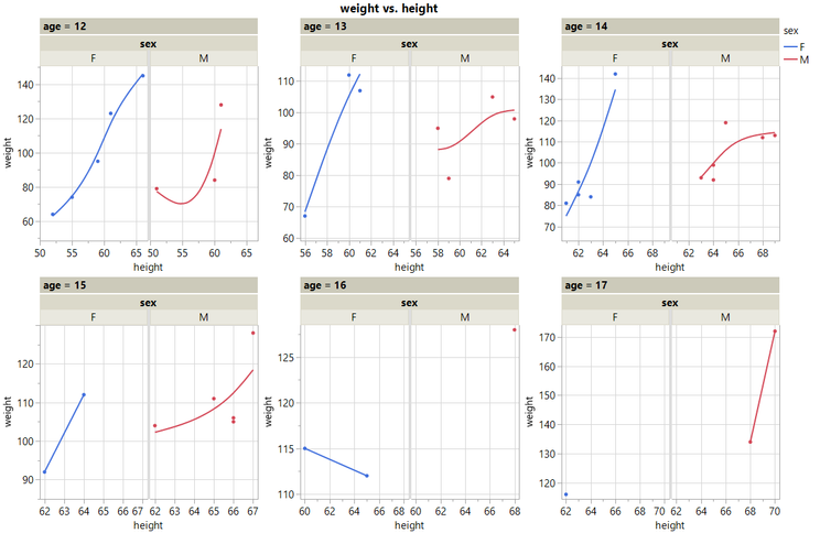

Happy news - the wish Graph Builder - align 'pages' next to each other got accepted and with Jmp 18 the user has  now more flexibility to align pages.
e.g.
which is very close to what @shampton82 wants here - just some space wasted by the many axis labels .

I've been playing around with the page "wrap" and it is amazing! and works well with the group X but I think having the group X be able to be used with wrap would still be useful.  The wrap layout is a little more compact than the page "wrap" and it never hurts to have an additional way to overlay a factor.  As an example:
Here I can break out by a product group (just showing one panel), then by alloy type (in wrap) and then if I could add in another layer of something like oven in the group X, oh man, there is some great deep diving in one chart!
