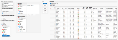

Using JMP's Update platform and getting error messages.
What is the improvement you would like to see?
If user has defined columns to be added and chose NOT to replace any of those added columns, add them as new columns with index.
Error:
Names Default To Here(1);
dt1 = Open("$SAMPLE_DATA/Big Class.jmp", Invisible);
dt2 = Open("$SAMPLE_DATA/Big Class Families.jmp", Invisible);
dt1 << Update(
	With(dt2),
	Match Columns(:name = :name),
	Add Columns from Update Table(:age),
	Replace Columns in Main Table(None)
Close(dt1, no save);
Close(dt2, no save);
but I would like to end up with two age columns: original age and newly created age 2 from the dt2.

you could use Tables/Join instead of Tables/Update.
Join provides an option to choose between merging columns and keeping both columns.
Status changed to: Yes, Stay Tuned!
Hello! This will be available in JMP 19, except instead of indexing to differentiate the added column, it will state the name of the source table in parentheses. For example, age (Big Class Families).

On the other and, I guess that some users used the default setting
as:
- add new columns
- skip existing columns
with the new functionality, JMP will always add duplicate columns.
Might collide with some user defined scripts ...
How about just adding the new columns when the user explicitly selects the columns?
-> better overlap with the existing functionality.
+ 100% of the new functionality.

Hm.
Ineed, replace any of those: prevents the new mode.
For the individual column everything looks like expected:
add it if the user wants it  - replace overrules add:
The issue is with the batch - comfort mode:
"add all the new columns" - and replace none (or just a few):
["default setting" was the wrong wording, default Add setting]
How to adjust the settings in the future to get the previous behavior of  "add any non-existing column - skip the existing ones"
- don't destroy existing columns by replacing them
- don't add duplicates of existing columns

New Proposal:
- if columns are "selected" to be added, and they already exist -> added with a postfix.
- for the batch-add mode:
columns are just added if they are missing. No postfix will be added.
[to guarantee compatibility with the previous batch-add-behavior.]
