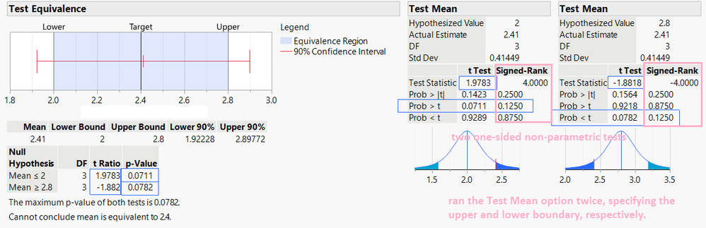

I have one request/recommendation for a future release of JMP.  In the one-sample equivalence test platform in JMP 16.0.0, I noticed that there is no correction for the non-parametric test case.  Yes I can, in essence conduct the test using the one-sample T-test platform: and by running the Test mean option 2X and picking off the appropriate tests as shown in the graphic below:
But I can’t get the Equivalence region nor can I get the TOST framework formalized in this same way which is what I like about the Test Equivalence Platform for the normality assumed case.

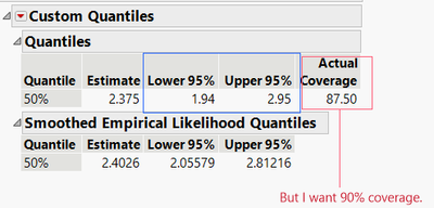

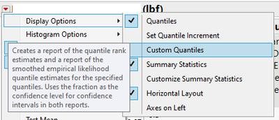

But in the 1-sample case, in the Distribution platform, I cannot do the same, why? The only way I know of doing something similar to this would be using Custom Quantiles in  JMP's Distribution platform, and that does provide a non-parametric estimate (albeit not the Hodges-Lehmann one, and I have trouble specifying the exact desired coverage for Confidence level of the TOST which is a standard 90% for a 5% significance level).
