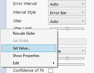

Currently when user want's to modify the slider value for example in Graph Builder, it is very difficult to do it based on exact value as you cannot see the value easily and you have to use slider.
Example below:
No idea what those values currently are unless I hover over and if I change the value I cannot see it while using the slider. And even if I could see the values, I cannot move the slider accurately enough to get the value I would like to have.

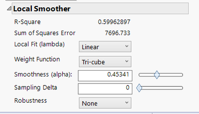

For example Fit Y by X offers this type of controls

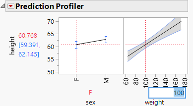

And with Profiler you can click the value and modify it

I would like to see the values all the time and have a possibility to write the values I want to use in addition to using sliders. Number Edit Box is one option how it could be handled, maybe combination of how fit y by x and profiler do it in the images above.

For the second part of the wish, I just learned from @jules :
right click the slider and use set value
