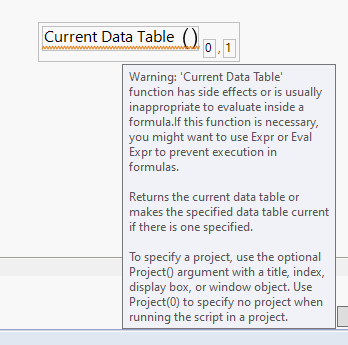

Add a way to get the data table in which the formula column belongs to without warnings
What inspired this wish list request?
Building JMP formulas which require a bit more than just referencing always the same column names
What is the improvement you would like to see?
Provide as a way to easily access the data table in which the formula column is in. Currently you either have to do scripting and evaluate expressions or use Current Data Table() which Formula Editor doesn't like
This would give as an option then to get all the column names for example while using As Constant to have a bit more dynamic formula.
Why is this idea important?
Makes it easier to build more complicated formulas without seeing warnings in formula editor.
