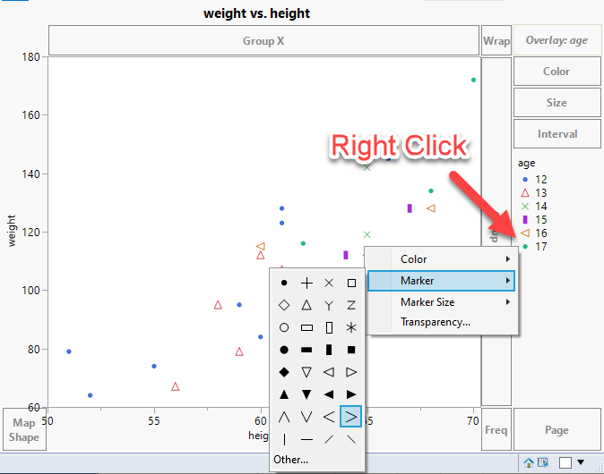

This might not be quite as automatic as it could be, but you can drag the category to overlay and then change the marker for each category level.

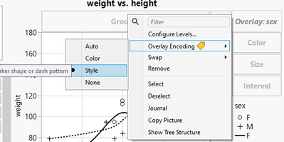

With Jmp18, it got easier - use Overlay Encoding -> Style to automatically use marker shapes instead of colors:
