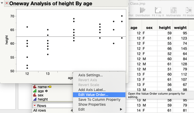

In JMP 16, when a categorical axis has a non-default order, (e.g., you've chosen another column to order the axis by), you'll have an option to save the order as a Value Order property.

Categorical axes in JMP 16 will have an option to edit the Value Ordering property.

With the release of JMP 16 categorical axes now have a right click option to edit the Value Order.

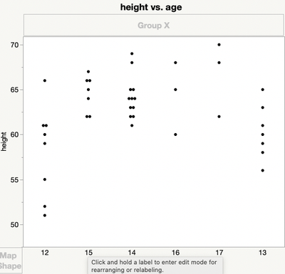

Categorical axes in Graph Builder can be edited directly by clicking and holding on the axis to enter a drag-to-rearrange and click to re-label mode.
