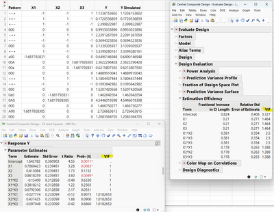

jszarka
Level V
I see the results delivered, but it isn't great per Case 00174254. Below is a 3-factor CCD with n=20 and the CCD-Uniform Precision design type chosen. With simulated data the VIFs are all close to 1, but the Evaluate Design platform looks a bit worse, with no results equal to 1.
mia_stephens
Staff
Thank you @jszarka , we have captured this issue. Moving this back to acknowledged.

jszarka
Level V
My hope would be that the VIFs would end up matching. After that is implemented, I would also suggest this show up by default in the Estimation Efficiency tab as it would be unlikely that most users would know that it is hidden there.

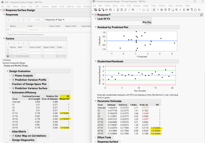

Sarah-Sylvestre
Level V
Status changed to: Yes, Stay Tuned!
If you are an authorized JMP user, you can try this out in JMP 20 EA1. To request to be a part of the EA, please visit JMP.com/earlyadopter.
In JMP 20, there is a new (hidden) column in the Estimation Efficiency table called 'Fit Model VIF' that is calculated consistently with Fit Model. In JMP 19, there was a hidden column called 'VIF' that used an alternate definition than Fit Model. The new column in JMP 20 uses the same formula from Fit Model, so the metrics should always be consistent. There is also a new platform preference to always show this column so that users that want to see the metric don't have to unhide the column.
jszarka
Level V
Yes, I do see this feature @Sarah-Sylvestre - thank you! It is much more intuitive than the "DOE VIF" term. I will continue to evaluate and add feedback. My first attempts were very successful, so this looks to be a great add.
The addition of a new platform preference is really good to have as well. We can deploy JMP with this preference built in, which provides easier use!
