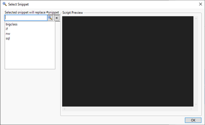

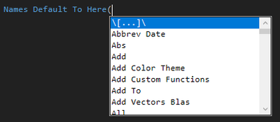

In optimal case I would want to open menu like this and upon selection of snippet having preview either in separate window or even better in the current script
My add-in currently requires me to write "#snippet" to the script window

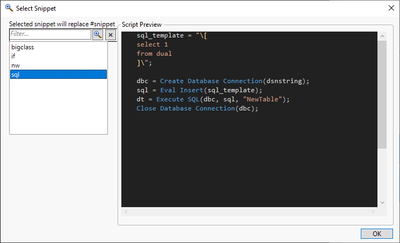

Then I can press the snippet shortcut Ctrl+Shift+Space to open snippet selector (search is prefilled with sql for example if user uses #snippet sql as the snippet string)
If I wanted to have sql snippet, I will first select it from the list box

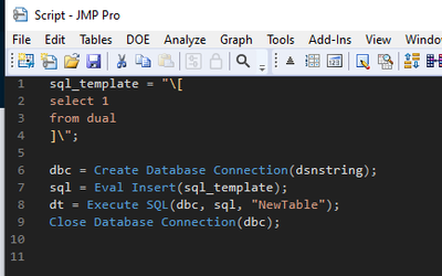

and then press ok button and the #snippet will get replaced by the script seen in the snippet window
