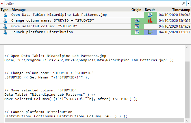

The enhanced log shows summary information in an interactive table and scripting details in a text pane. To open the log, select View > Log (Windows) or Window > Log (macOS).

Enhanced LogEnhanced Log
This log shows that the following actions were performed:
  • The Nicardipine Lab Patterns.jmp data table was opened
  • A column name in the data table was changed
  • A selected column in the data table was moved
  • The Distribution platform was launched on the data table
In the table, click the icons to open:
  • The data table (must be open in JMP)
  • The data table with impacted columns highlighted
  • The analysis (must be open in JMP)
In the text pane, you can see the equivalent JSL that performs each action.
