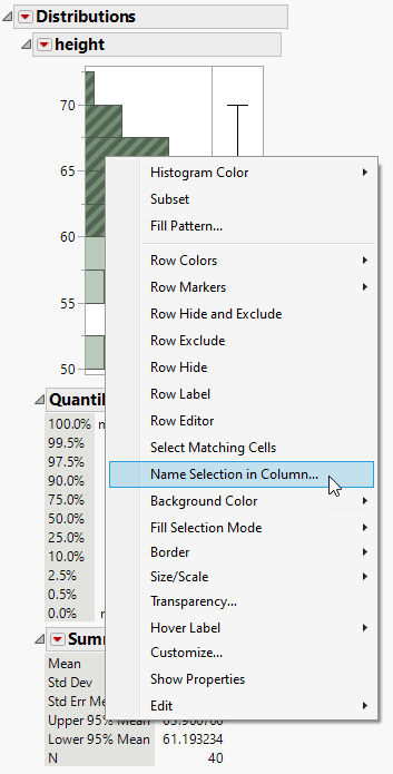

  4. In the histogram, click and drag to select the five bars above 60 inches.
  5. Right-click in the histogram and select Name Selection in Column.

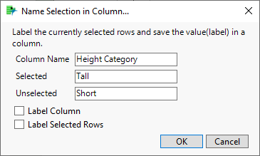

    Enter these values:
  6. Next to Column Name, enter Height Category.
    Tip: If you are using this option several times in the same data table, update the default column name each time to prevent overwriting existing columns.
  7. Next to Selected, enter Tall.
  8. Next to Unselected, enter Short.
    Name Selection in Column OptionName Selection in Column Option
  9. Click OK.

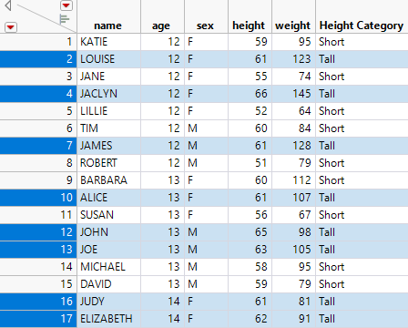

    In the data table, the new Height Category column appears with the specified values.
