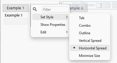

I have big issues creating tabs in a new journal using drag and drop from the journal menu bar. Even when I copy the result from your script into one of my journals, the result looks as below:
And not like this, which is what I want:
Can you help? (I imagine something with my settings is off...but can't figure out what.)

hi @Ressel ,
your screenshot looks like "Horizontal Spread" - which can be activated via the right click menu:
It's very easy to activate this mode ...

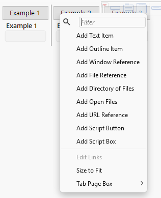

To come back, you nee some confidence! In 99.x % of the cases, the right click menu will look like the one below - without "Set style". But for some positions (e.g. the top part of the vertical lines) it will work (see 1st screenshot)
