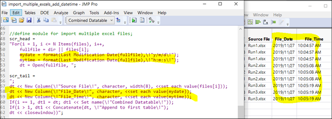

voy-voy
Hallo, thank you @MKawaguchi for the jsl file. It is verry helpfull.
Is it possible also to add a collumne with the file Date (and Time)?
I try it but it not worke.
Thank you in edvanced.
MKawaguchi
Hi @voy-voy ,
Thank you for your comment.
I added 2 rows in "scr_head" variable for file modification date and time.
mydate = format(Last Modification Date(fullfile),\!"y/m/d\!");
mytime = format(Last Modification Date(fullfile),\!"h:m:s\!");
Then I added 2 rows in "scr_tail" variable to create columns for date and time as well.
dt << New Column(\!"File_Date\!", character, <<set each value(mydate));
dt << New Column(\!"File_Time\!", character, <<set each value(mytime));
As a result, you will get file_date and file_time column in your combined datatable.
I put overall script at the bottom of this comment. I hope it helps!

voy-voy
Thank you very mutch, now it works perfect.
