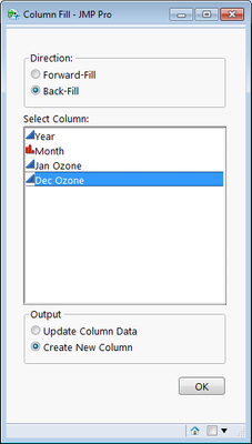

The script allows you to specify the direction of the fill, and whether to fill in-place or to create a new column:
