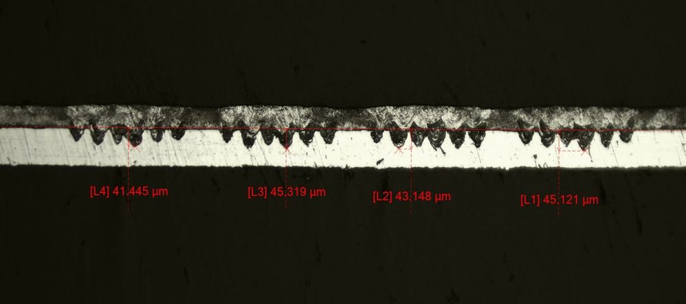

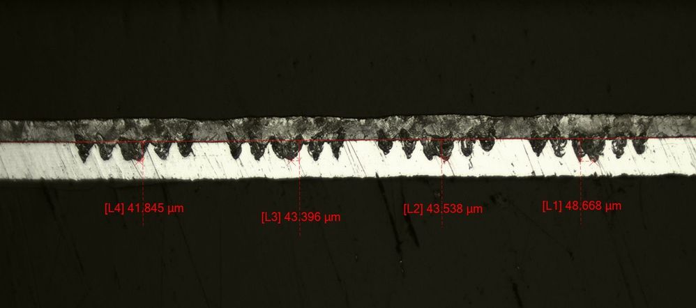

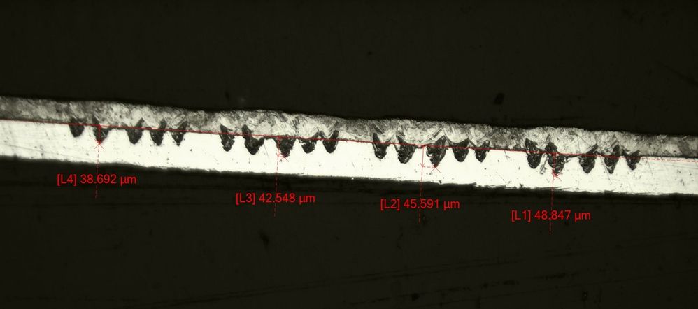

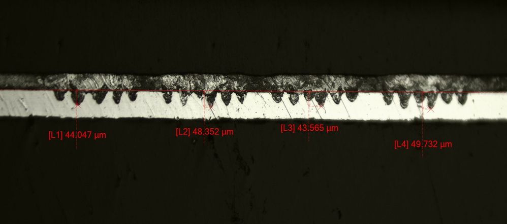

     As picture show, I want save red value in JMP, could you help me to change JSL?Thanks!
Jamy_Xia
@Chris_Liu
this is a good topic,could you work out it?
