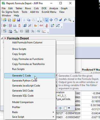

  As for your other question about exporting the formula, there is already a way to do that in JMP. Once you've made a model, you can publish the model formula to the Formula Depot platform (see below). Within the Formula Depot Platform, you can use the red hot-button to export the code in different formats, like C, Python, Java, SQL, and so forth. This might get you where you are looking in order to run the formula in Excel. However, if your prediction formula is easy, you might be able to manually "transform" it from a JMP formula to an Excel formula. But, if it's complicated, then you might want to keep it as a JMP file as it might perform faster when evaluating large data tables.

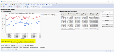

Hi All, I'm happy to share that I have updated the JSL code for automated tuning. I've fixed a couple strange bugs in it and also added a new feature to the results window that allows the user to see different fit statistics on the y-axis, see below. There is still the ability to step through the different tuning parameters on the x-axis, but now you can also see how the other fit statistics beyond R^2 change. Attached is the latest version, 6.0. Hope it can help everyone. If you do come across any issues in the code, please let me know and I'll try to fix them ASAP.

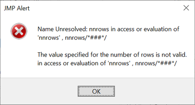

I'm using the tool and works great for random forests, support vector machines, etc. However, I'm having issues when tuning a neural network with a validation column; I get the following error:
Also, when I was tuning a random forest, I was getting an error because the validation column name was "Validation 9 months - 1MT 21", so I changed it to "Validation_9" and it worked.

  I'm glad you're using the tool and it's working out for you. Sorry that you're getting an error when running the NN. I think it's because you have not selected a penalty method. By default they aren't checked because when you do a "Recall", it actually un-checks the previously checked items. Anyway, I believe if you select at least on penalty method, then you shouldn't get that error. This is independent of what type of cross-validation you're using.
  As for the long validation column name, it could be in how the column is referenced with spaces vs. underscore "_" text, or that it's just too long.. The spaces might end up causing an error, I have not tested this out for long column names, but at least for a short column name like "V test", it works just fine. My guess is that it has to do with the length of the column name, but I'm not 100% sure on that.
  I might update the code to account for the NN and the penalty method so that it first checks to make sure that at least one penalty method is selected prior to performing the fits. It's my understanding that the NN platform requires a penalty method.
