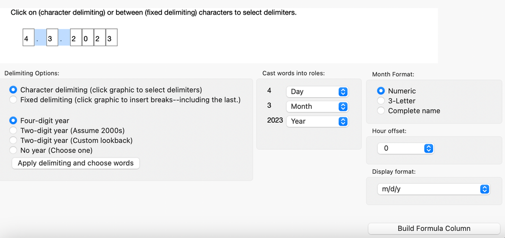

@hogi
Both of those examples are delimited, so you can fill out the dialog as below. The second example has slash delimiters rather than dots, but it will otherwise be the same.
hogi
Thanks :)
Another way to get March 04:
Informat( "4.3.2023", "Format Pattern", "<DD></><MM></><YYYY>" );
Informat( "4/3/2023", "Format Pattern", "<DD></><MM></><YYYY>" );
