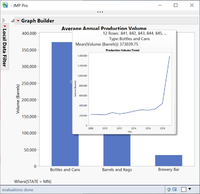

This drill down graph will allow us and others that we share this data table with, to explore brewery trends in the US. I'm going to hover over the state of Minnesota and you can see that I can drill in to Minnesota. And I can see what the average annual production volume by type and how that breaks out. And then I can also do another drill in where I'm hovering over production volume produced for brewery consumption. And I can see a trend what that looked like over the last several years. All right, let's see how we can build this together. So we're going to build this Using graph builder and the way that we're going to do this is we're going to build each one of the three layers individually. And then we will nest the scripts within each other kind of like a Russian doll. So let's go ahead and build that first layer. So the first layer that we looked at was a map of the US. So I'm dragging state into the map zone which brings up the shape of each state. And then I'm dragging volume not interrupt to I don't know if you're sharing anymore. No. See?

And what we're going to do is nest them within each other. So I'm going to grab the code that creates this particular graft. So I'm going to start with the third layer and nest within the second and then take the second and nest within the first. So I'm going down to save script Copy to Clipboard. I'm going to go to the second layer and I can essentially right click on any one of these graphs, or these bars. Go to hover label and paste graph. What once I do that, I hover over one of these bars and I can see that I'm getting a graph Now, our third and last step of nesting is to take this particular script and copy it and then paste it into the first layer. So again, I can right click anywhere in this graph, go to hover label, and say paste graphic. And now we can test this. So if I hover over the state of Colorado, for example, you can drill into Colorado.
And I see that brewery production for burry bars pretty low in this state over the last 12 years. If I hover over bottles and cans, you can click in there and see the production volume trends over the last 12 years for Colorado.

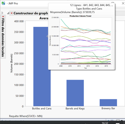

However on the third lawer all states appear and when I click on your script there is all states as well .... is there something special in my settings I should care about ? thank you for the help. Emmanuel

Hello @wendytseng
I tried both scripts "Drilldown ... in US" and "Brewery Trend Drilldown" and both returns me the same graphs (see below) when I go through MN as instance
The reason why I'm suspecting something wrong in my settings ...

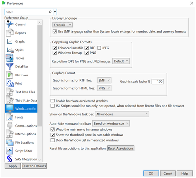

I initially set my language preferences to French to present to our customers in their mother tongue,
When I set back to English, script works properly.
Depending on settings on A) "Windows specific - Display language" and B) "General - Save scripts" & "General - Displays indexes" I obtain different graphs ...
Note, that is the case when I redo the whole sequence by myself saving my own scripts.
As instance
Case study 1): for A) English and B) selected (thus in english) everything goes well. It is what you presented and I'm able to repeat identically (thank you for the nice video).
Case study 2): for A) French and B) selected (thus in english) Graph 1 & 2 are correct while all States appear on graph 3. It is what I mentionned in my previous mails.
Case study 3): for A) French and B) deselected (thus NOT in english) Graph 1 is correct. On Graph 2 bars do not appear thus I do not have access to Graph 3.
