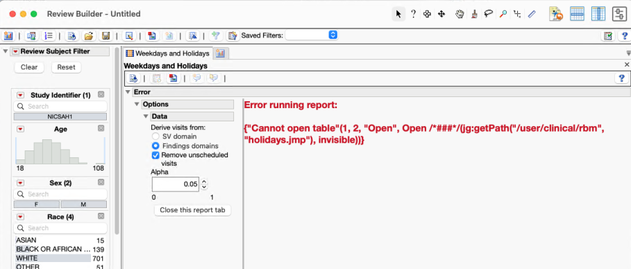

Running the Weekdays and Holidays report results in the error shown below. The report fails to generate.
There is a workaround to run this report in JMP Clinical 18.2.1 on Mac. In the JMP Python Script Editor, run the below script to properly install the libraries.
import jmputils
jmputils.jpip(["install", "--no-index", "--find-links=/Library/Application Support/JMP/JMPClinical/18/Clinical/JSLFiles/PythonLibraries/holidays"], ["holidays"])
The Weekdays and Holidays report can now be generated.
