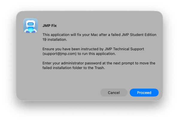

Step 1: Download the JMP Student Edition Repair tool.
Step 2: Unzip and launch the tool, and then click Proceed.
