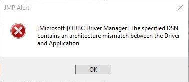

Whether you prefer to use Open Table or Query Builder in JMP®, you may encounter the error: "The specified DSN contains an architecture mismatch between the Driver and Application" (Figure 1.1).
Figure 1.1

With Database Management Systems (DBMS) such as Oracle, MS SQL Server, PostgreSQL, etc., you need to configure the ODBC Data Source that corresponds with the architecture of JMP. Meaning, if you have 64-bit JMP, you configure your data source under the ODBC Data Source (64-bit). If you have 32-bit JMP, you configure your data source under the ODBC Data Source (32-bit). Figure 1:2 provides a layout as to how the Operating System, JMP, and ODBC driver source correlate when considering their architecture (Figure 1:2).
Figure 1:2
Operating System JMP ODBC Source File Location
64-bit Windows 64-bit JMP 64-bit ODBC c:\Windows\System32\odbcad32.exe
64-bit Windows 32-bit JMP 32-bit ODBC c:\Windows\SysWOW64\odbcad32.exe
32-bit Windows JMP (32-bit only) ODBC (32-bit only) c:\Windows\System32\odbcad32.exe
Fixing the error would mean configuring an ODBC source that matches the architecture of JMP as shown in Figure 1:2 above. Please consult your IT Administrator for help obtaining a 32-bit or 64-bit driver for your database management system, that matches the architecture of JMP so you can avoid this error using Open Table or Query Builder.
