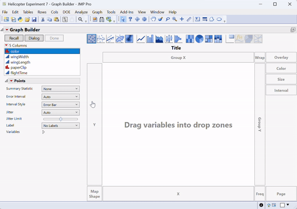

To avoid the crash, we recommend clicking instead of drag-and-dropping (see GIF below).
