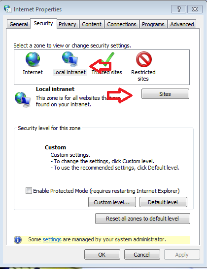

  2. Navigate to the Security tab.
  3. Open the local intranet zone.  Now click the Sites button.
    Figure 1Figure 1

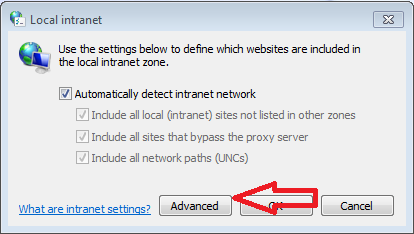

  4. When the Local intranet window opens, click the Advanced button.
    Figure 2Figure 2

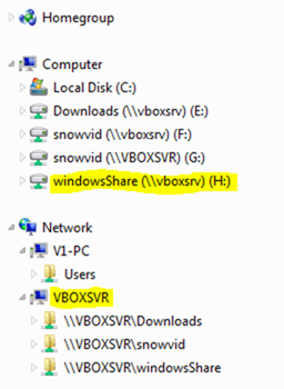

  5. In the Local intranet Advanced settings window, you can add the network location of JMP files. You need two entries for each location and both require the network location server name. You can find the network location server name by looking at your My Computer window. The server name is in parentheses.  See the example image below.
Figure 3Figure 3

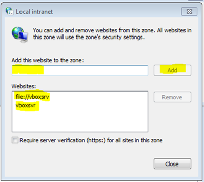

First, enter the server name of the network location in the text box and click Add. In the example below, the server name is vboxsvr.
You also need to enter the file URL, which appears as file://server. Type in the file URL in the text box and click Add. In the example below, the file URL is file:// vboxsvr.
Figure 4Figure 4
