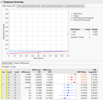

In Response Screening platform, labeling in Means Differences report is incorrect with a character grouping column
When a character Grouping column is defined in a Response Screening analysis, the labeling in the Means Differences report is incorrect. Only a single group label appears (repeating values are suppressed), making the user think that all comparisons are from one group.
For example, running this script:

produces the following output.
There is no workaround at this time. The issue will be addressed in a future JMP version.
