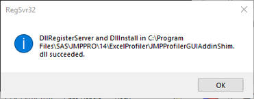

  1. Click enter on your keyboard to register the .dll. You should see the following prompt.
Figure 1Figure 1
