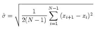

When each subgroup sample contains a single observation (ni=1), the process standard deviation σ is estimated as
where N is the number of observations and xi,x2,...,xn are the individual measurements.
