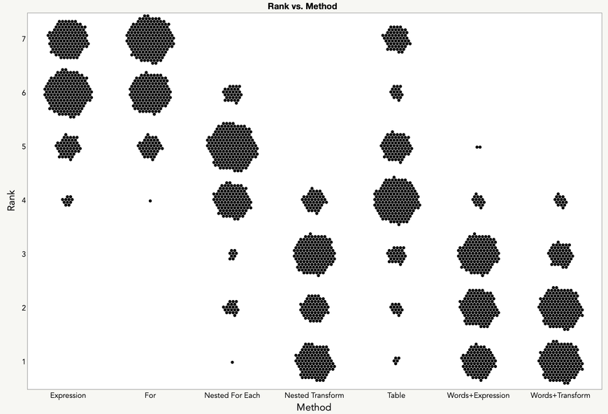

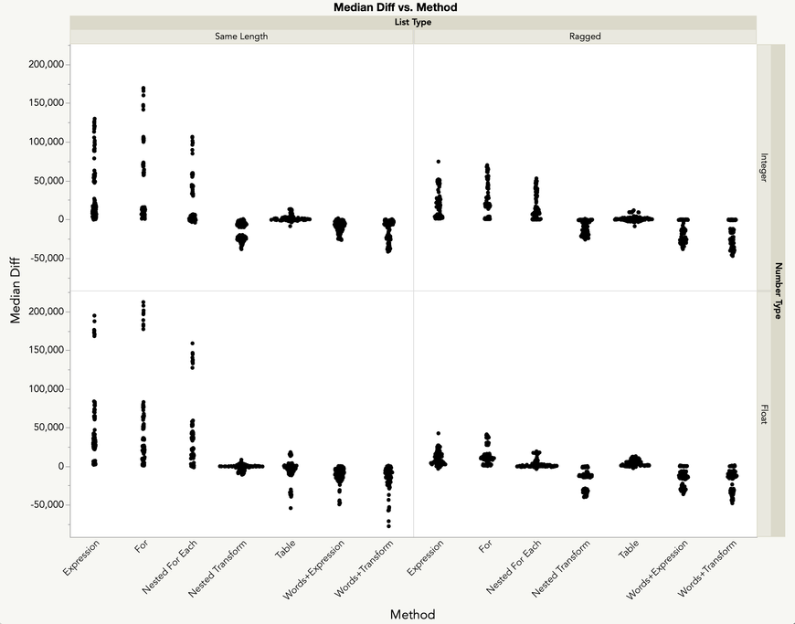

To compare methods, I calculate the rank order of each method by run and replication and the difference between the run time and the median run time for all replications within an experimental run. Smaller is better. The graphs below suggest Transform Each, table operations, and the Words methods were superior. While the actual time difference are small (values are in microseconds), these methods are consistently ranked higher and have less variability.

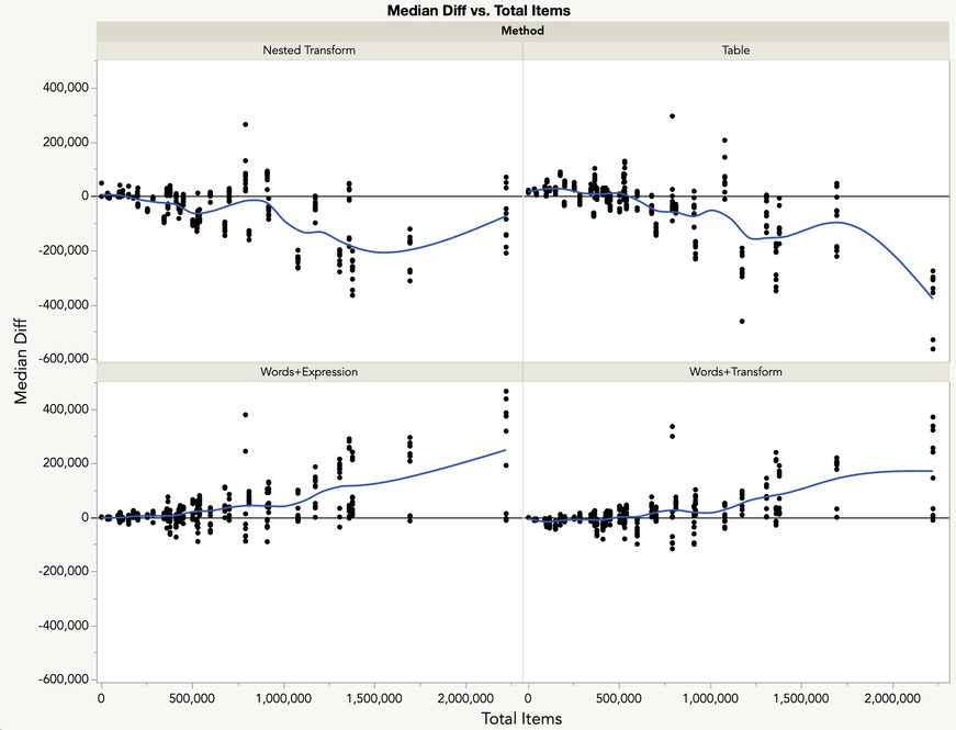

To see if there were differences among the four methods, I reran the experiment with bigger lists (List of lists big – Experimental Runs.JMP and List of lists big results.JMP). Looking at the time differences from the median time within run, it appears that as the total number of items increases, Transform Each and table operations perform best. This is a fortunate result, since Transform Each was only just introduced in JMP 16, and table operations provides a good solution for those folks still on JMP 15.

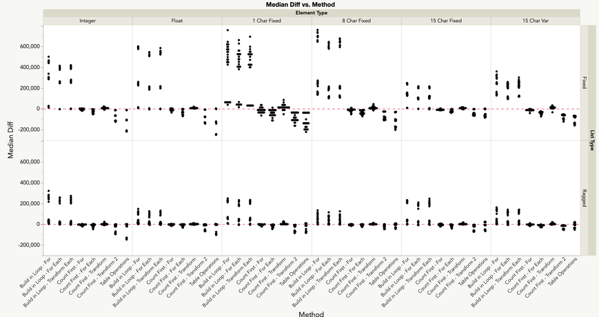

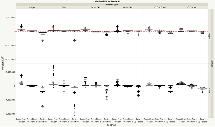

The code for testing the different transposition methods is in Transpose lists.JSL. As above, a space-filling design was used to compare the output under different conditions. Unlike the code above, a new data structure is created for every repetition. The first three methods read the input and built the output in a single block. The next three predetermine the size of the output lists first, before processing the input. The second to last method used table operations and the last Transform Each, structured to use its output values.
Predetermining the size of the output lists proved to be faster than attempting to do this in a single block. The different implementations of Transform Each show the speed improvements gained by working with its output values. The results are in Transpose results.JMP. An experiment with larger lists comparing For Each, Transform Each (2nd implementation), and table operations can be found in Transpose results big.JMP. The results suggest that table operations, in general, outperform the other two approaches.
