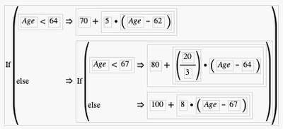

One topic that we've heard quite a bit of discussion around the Internet is when does it make most sense to start collecting Social Security. For those folks who aren't familiar with U.S. Social Security system, the basic idea is that the government provides a monthly income for those people who have contributed for a minimum number of years into the system. The monthly amount depends on how long and how much you've contributed, and it's adjusted for inflation on a regular basis. Another factor that affects how much you can collect, and what's most important for the purpose of our post, is the age at which you start collecting. Currently, you can collect as early as age 62 at a reduced rate: 70% of the amount at full retirement age (67). You can also delay collecting until age 70. Doing so lets you collect at 124% of your full retirement age benefits. The exact formula for calculating how much you collect is:
Age is rounded down to the closest month. The result is expressed in percent relative to full retirement age.

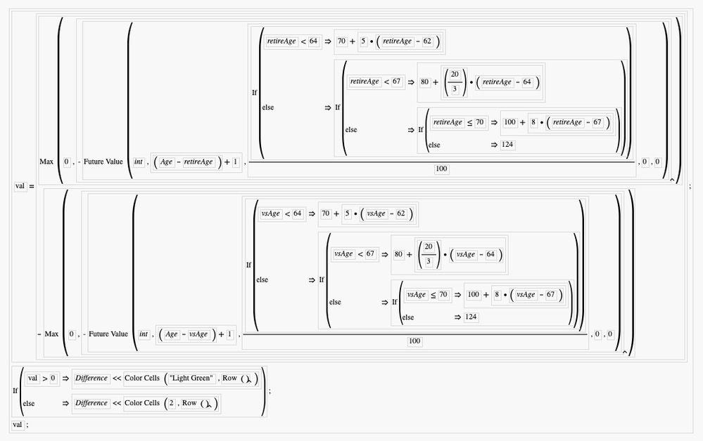

where retireAge is either the hard coded retirement age or a table variable containing the retirement age, we don't have to worry about the period number. Going one step further, if we replace pmt with the formula at the beginning of the post, we can use it for any of the retirement ages.
In this formula, int is a table variable with the interest rate. Max is used to deal with the situation where Age is less than retireAge and a negative value is returned.
Comparing retirement ages
Let's say we're interested in the difference between two retirement ages. We can create a formula that's the difference between two Future Value functions. The first will be as above. In the second, we will substitute vsAge, a table variable giving the alternative retirement age, for retireAge. Let's also say we want to interactively color positive value rows green. This can be done by treating the Formula Editor formula like a block of JSL code. To get it to work properly, you need to use multiple statements and know that the Formula Editor returns the value of the last evaluated statement. The general form will have three statements:
  1. variableName = Expression calculating the difference;
  2. Expression setting the cell color relative to variableName;
  3. variableName;
In the example, val is the variable name. The color is set using
If( val > 0,
	:Difference << Color Cells( "Light Green", Row() ),
	:Difference << Color Cells( 2, Row() )
The first argument to Color Cells can be a standard color name or a color number. Difference is the name of the column where the formula appears, so it is self-referencing. The variable val appears at the end, so that the actual value appears in the data table.

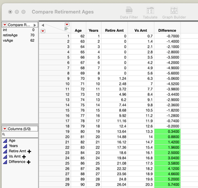

We now have a table where we can make comparisons between two different retirement ages and different investment scenarios by just changing table variables. Let's say we want to compare retiring at 70 vs. 62 without investing. We would have to wait until between ages 79 and 80 before we broke even.

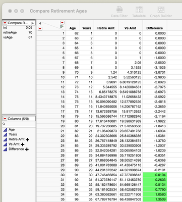

What about comparing ages 70 and 67, where the distributions are invested at 5%. Breakeven occurs between ages 90 and 91.
