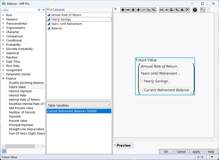

After this, it's time to create the formula in the Balance column. This is really easy, since it's already included with JMP. However, two parts might not be obvious:
  1. The Future Value function can accept four parameters, with the fourth being the current amount.
  2. Note that I added some minus signs in the formula. While it's simpler for me to think in terms of all positive numbers, TVM calculations assume that payments and initial values are negative. Think of it as relinquishing money to the savings account, if that helps.

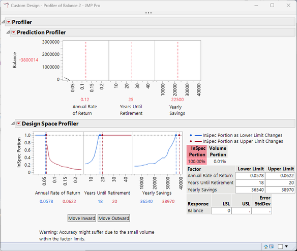

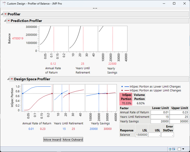

Finally, it's just a matter of using the Graph...Profiler and some red triangle options to get an interactive tool to predict retirement. The Design Space Profiler is useful here because it shows that Mike, who is 45 and only has $100,000 saved so far, has about a 70% chance of having $1.5 million saved if he works between 15 and 25 more years, saving between $20K and $30K each year, assuming his returns each year vary between 1% and 23%.

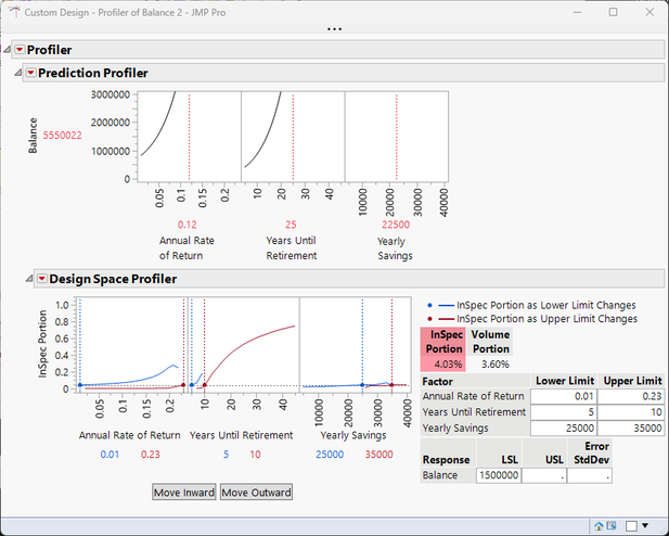

With the script for this tool saved to the data table, it's simple enough to adjust the Current Balance table variable and run other scenarios. For example, Chris, who is 57 and currently has $150K saved for retirement, only has about a 4% chance of having $1.5 million saved for retirement in the next five to 10 years, even after putting quite a bit into savings.

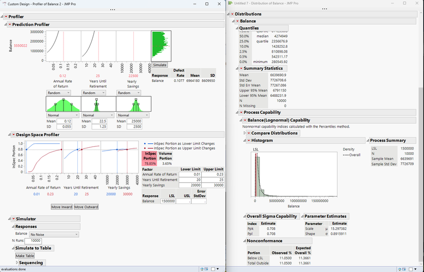

Finally, if I really want to dive into the details, I can simulate all this to a table and look at the results in the Distribution platform.
