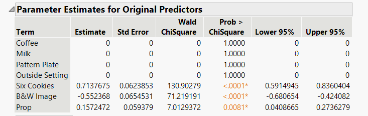

Many thanks to Clay Barker for helping collect data during the social and prepare the analysis. He set up the data set to be used with the Bradley-Terry model as has been seen in a couple of previous posts (here and here). Full disclosure: Since the data was being collected real-time and Clay had percentages available, the percentage of each pair of pictures was entered. So it pretends we had 100 respondents, when we had between 70 and 80 at any given time. Modeling this as the probability that picture A would be selected, during the social Clay showed us the main effects model in JMP:
What this tells us is that based on the respondents, six cookies are better than two (which came up in the discussion), color is preferable to black and white, and there might be a small effect by using a prop.

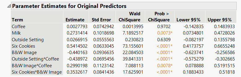

After the social, considering interactions and going through some model refinements, we ended up with this model:
Still much the same story – six cookies and a color image are the main drivers, but milk/coffee/tea and the outside setting can be, depending on what you are comparing it to. The interactions factor in what the paired picture has, so it can be a bit more difficult to see from here. If you want to dig more into the details, I have attached the original data table and the one set up for the Bradley-Terry model.
