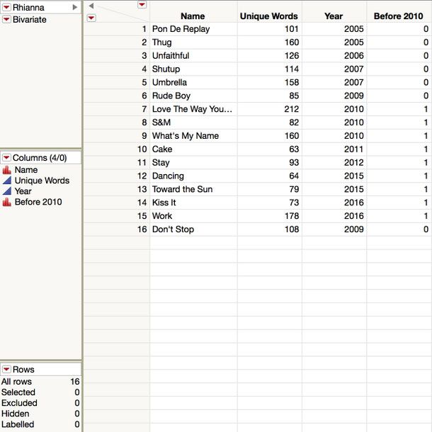

Significance tests for regressions are exactly the same as for ANOVAs. I’m going to look at the relationship between number of unique words in Rhianna songs by year released [1] (there are only so many times you can say “work” in one song).

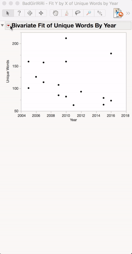

To do this in JMP, open BadGirlRiRi.jmp (attached).
Using the Analyze>Fit Y by X, Drag Unique Words over to the Y box, and Year to the X box.
Click Ok and the output window will pop up. Using the red triangle under Bivariate Fit to select Fit Line.
Notice the Analysis of Variance table displays our Sums of Squares, Degrees of Freedom (DF), Mean Squares, and our F test. Since our F is relatively close to 1, and our p-value is way higher than 0.05, we do not have evidence that there is a statistically significant relationship between number of unique words in Rhianna songs and year, but I'm keeping an eye on you, Riri....
