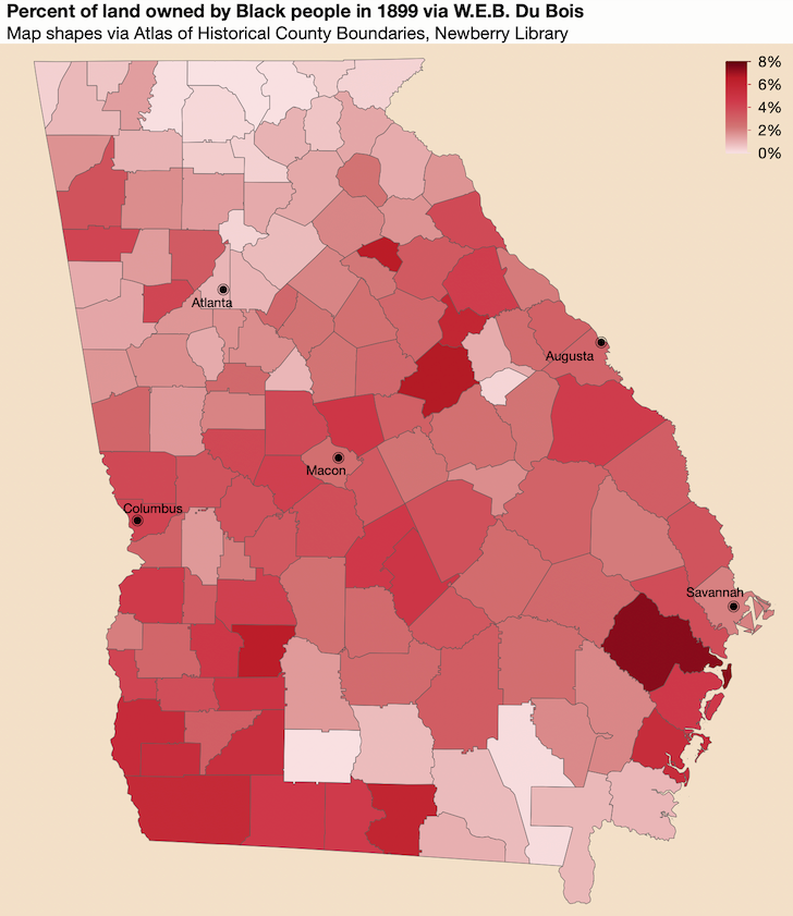

As a weekend project first shared on Twitter, I decided to have a go at this map of land ownership by Black people, first to recreate it and second to augment it with a color gradient that reflected the data values. In its original form, the colors only serve to distinguish the counties.

I had recorded each county’s color (one of seven) in my original data entry work and added a Value Color column property to mimic Du Bois’s original colors. Then it was just a matter of dragging that variable into Graph Builder’s color drop zone to color the counties. The map projection is a little different and I couldn’t capture the beauty of his hand-filled colors, but otherwise I was happy with the reproduction.
Finally, I was ready to augment the graph by showing the acreage with color. As a way of taking the varying county sizes into account, I colored the counties by the percentage of land owned by Black people instead of the raw acreage value, which also provided a little context for the amounts.
Adding markers for the cities to the map required a little advanced work. I added rows to the table for the five cities in the original map along with their longitudes and latitudes, and then I layered a Points element over the Shapes element in Graph Builder and labeled the rows for the points. The final touch was to use the Unicode “fisheye” character, ◉, as the marker shape.
