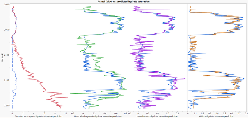

Actual hydrate saturation (blue) compared to predicted hydrate saturation for Standard Least Squares (red), Generalized Regression (green), Neural Network (purple), and XGBoost (burnt orange).Actual hydrate saturation (blue) compared to predicted hydrate saturation for Standard Least Squares (red), Generalized Regression (green), Neural Network (purple), and XGBoost (burnt orange).
Standard Least Squares just doesn't cut it. It robustly models the Interval 1 but completely fails to predict with any accuracy the hydrocarbon saturation in the lower two intervals. Generalized Regression (Adaptive; Elastic Net) is marginally better but generally overpredicts the lower two intervals by 0.1 to 0.2 saturation units. The machine learning models do a much more robust job, but I give the edge to XGBoost. Neural Network produces a much "noiser" signal in that there are numerous kicks that account for 10-20% over and under prediction, while XGBoost provides a much more stable prediction at both low and high hydrocarbon saturations.
This is a common theme I observe when working with geologic and/or downhole data: The natural systems are incredibly complex, fraught with heterogeneities, and machine learning models (Bootstrap Forest, Neural Network, and XGBoost, etc.) tend to provide better predictive models overall.

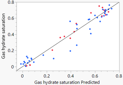

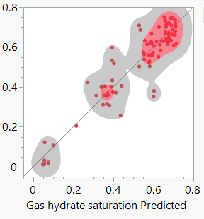

Model results for validation data sets of XGBoost (top) and Neural Network (bottom).Model results for validation data sets of XGBoost (top) and Neural Network (bottom).
