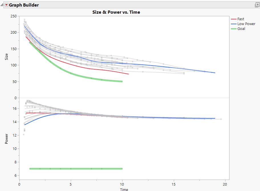

I'll use a slightly modified Mill DOE.jmp from the Sample Data to make this example. The file is attached to this blog entry. The data represents a designed experiment to optimize a roller mill process, with the goal being to have the size curve shrink rapidly. I've added a column which tracks power usage during each experimental run. The goal for this column is to minimize power usage during the process. I've also added a target batch to the data as Batch 0 and I've removed some of the other columns in the data table.
This is now a good data set to illustrate how to optimize competing curves: I'd expect that using more power will cause the process to reduce the particle size faster, and I'd hope that there is a happy spot in the design space where power usage can be low and where the milling process can be quick. In the graph below, I can see that the fastest DOE run (red line) is near the middle on power usage, and the lowest power usage (blue line) is largely in the middle for the milling process time. The green lines represent target curves for each output.

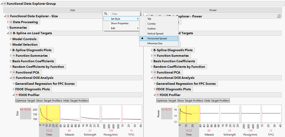

Focusing on multiple outputs at once is easy. Once I loaded the targets for each output, I fit B Spline models to each, then I right-clicked on the Tab Box at the top and selected Set Style > Horizontal Spread so I could see both profilers side by side. Once the profilers are linked (click on the profiler red triangle and select Factor Settings > Link Profilers), I can see tradeoffs as I optimize one output. It makes sense that the fastest size happens at the high beads, high bead strength, low coolant, high temperature corner. Likewise, the lowest power usage comes from a different corner where temperature and flow are low.

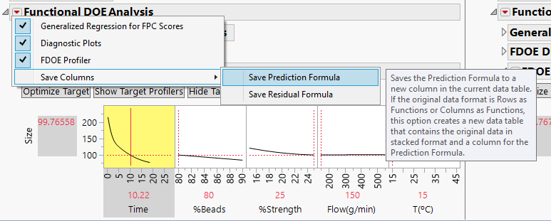

  1. For each of the curves, select the red triangle in Functional DOE Analysis. Select Save Columns > Save Prediction Formula.

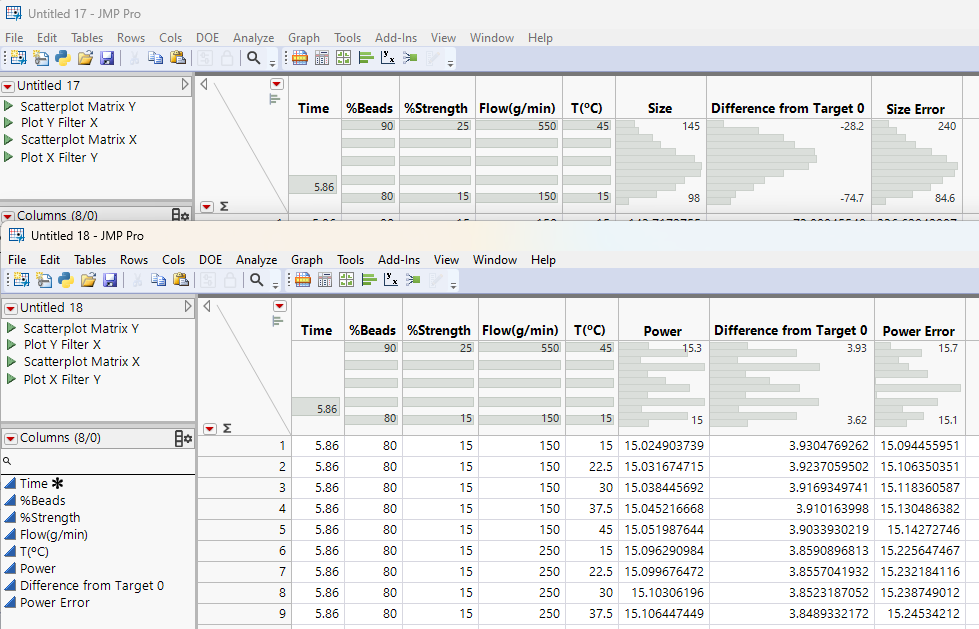

  3. In the Table that pops up, rename the column “Integrated Error from Target 0” to “Size Error.”Jed_Campbell_6-1729112203460.png
  4. Repeat Steps 2 and 3 for Power, renaming the “Integrated Error” column to “Power Error.”Jed_Campbell_7-1729112276204.png
  5. To simplify things, you can delete all the columns in both grid tables, after the “Error” columns you previously renamed.Jed_Campbell_8-1729112392136.png
  6. Use the Tables > Update tool to combine the two tables. You'll need to match all the first five columns, but this doesn't mean lots of clicks: just select all options between Time and T(°C) in both column groups, then select Match.Jed_Campbell_10-1729112510104.png
