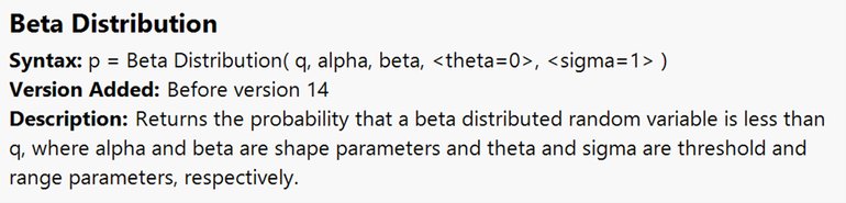

For example, take the Beta Distribution function from JSL (screenshot from the Scripting Index). The Beta Distribution function is used to model random variables that are bounded between 0 and 1, often used in Bayesian statistics.
We might fix alpha and beta to something like 0.5, and test a number of different values of q.
